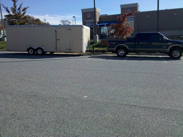

I was going to hold off till I got alittle more finished but it has been to quiet on here and it is going really slow. And wouldn't mind input. A couple of weeks ago my brother told me about his boss's friend selling an enclosed trailer for a good price. I kinda shrugged it off, I don't even have a truck. And i can't afford an eclosed trailer. Well it turned out to be a really good price and after thinking about it for a while i decided to go for it.
24' carmate
trailer build PART951289244715221
Only things it needs to pass inspection was 2 tires dry rotted, a fender and 2 light bulbs. But i can't make it that easy. The axles on it were only 3,500lbs axle and with the trailer weighing 3000 by the time i put a 4,000 lbs jeep in there i am already pushing it. Before I bought the trailer i priced 5200 lbs axles and springs and it wasn't that bad and still put the trailer alot under what similar trailers are going for. I Call Carmate and they said that model frame will handle the wieght all i have to do is switch axles springs wheels and tires send them a reciept and they would send me a new vin plate.
list of stuff to do:
-install 5200 lbs
-replace fenders, had a hard time finding a replacement of that style
-PAINT outside. ugly cream color. My friend calls it a giant stick of butter. rust stains from screws (wait till spring time)
-replace 1,000,000 screws
-paint inside. it is just wood inside. I want to make it so 12volt lights will be able to light it up well
-replace one floor board. It is bowed from the cars front wheel sitting on there for a while.
-add to the frame where tires are going to sit to keep wood from bowing again
-put tie downs in to the frame. the guy just had them bolted though the plywood.
-add storage for tools, spairs and fluids.
-add sleeping/lounge area
-make air tank to fit under trailer between frame
-add batteries
-what ever else comes to mind
